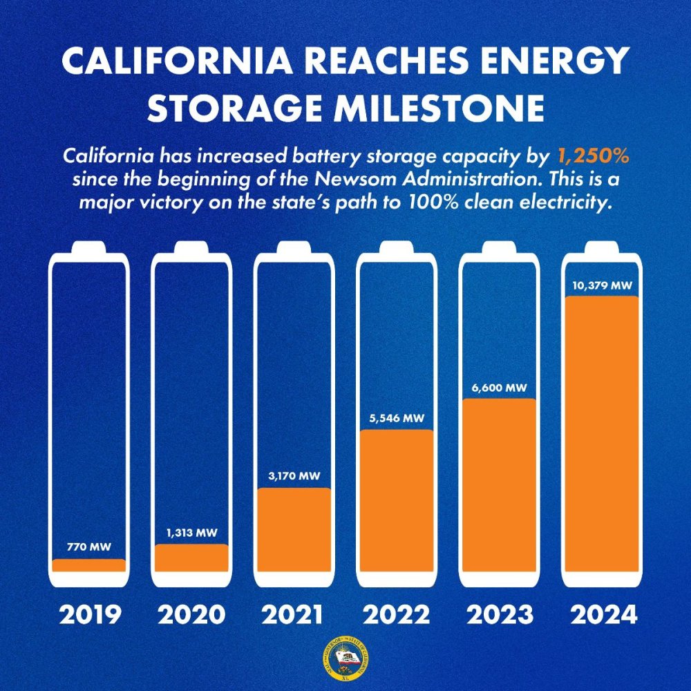

Not again. One of these hang wringing articles about the dreaded battery storage issue. Look, California is getting it done and the world is watching. Plunging battery prices are seeing to it it’s the go-to investment for those needs. The latest increases came during both the restricted working era of Covid and one of supply problems. Imagine the uptake when the latter completely goes away. Total storage is now at +14 GWh, as more and more gets added almost every day.
10,000 MW storage barrier crossed
Single 680 MW battery project online late 2024
10,000 Megawatts installed and going
-12 (57 / -69)
The article clearly addresses the CA storage projects. It also points out that the time scale for storage for such systems isn't nearly long enough to cover the expected doldrums in other locations around the world. Germany may have very different expected power generation expectations than California so it's not unreasonable that Germany may need different storage investments than California.
143 (145 / -2)
As battery costs become cheaper and cheaper, there’s absolutely no reason to not install a surplus 3x, 5x or more of actual on-paper needed capacity. Any situation should be readily covered.
14 GWh? Cool, you can power your state for whopping 25 minutes!
41 (53 / -12)
Storage is storage. Cover your needs and move on, especially as it becomes cheaper and cheaper. We don’t build water reservoirs to hold exactly our daily water needs. We build them to hold many days, weeks or months worth of supply. I foresee battery storage taking the same path.
Storage is storage, but when you need 1000x the current capacity you start running into limits about cost, physical space and sourcing materials. If you can find something that's 10-100x cheaper then the numbers stack up somewhat better.
