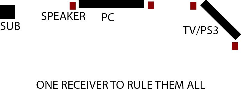

To be more specific:
I have a computer against a wall and I have it hooked up to a receiver that's hooked up to two bookshelf speakers and a subwoofer.
I also have a TV/PS3 in the corner. Obviously, I could hook that up to the receiver and get sound from said speakers and subwoofer.
But equally obviously, that's no good because speakers are directional.
The dumbest solution to this problem is to go out and buy two new speakers, a new subwoofer, and a new receiver, and have to hook all that up to the TV/PS3.
So I am wondering whether there's a smarter solution. Can I just buy two more speakers, position them appropriately vis. my TV/PS3, and run them through the same receiver? In other words is there a receiver that will do this? Isn't that what speaker A/B switching means? And while I'm at it, can I use the same subwoofer for the "B" speakers, or can you not even connect a subwoofer to "B" speakers?

If I'm thinking correctly you should be able to buy a second set of speakers and center them appropriately for the TV/PS3. Hook them up to your "B" output and the audio out from your TV to the receiver. Turn off your A speakers and turn on the B and you should be good.
The thing I'm not sure about is the sub. How is it currently hooked up? If it's a powered sub and connected through a sub out signal level RCA connection I think it should still work fine. If it's through the speaker wires that will get a bit more complicated.

Bingo. This is what I'm looking for. Is there a receiver that does this?
[url=http://meincmagazine.com/civis/viewtopic.php?p=25698617#p25698617:v8ga24wj said:
Sp@nky[/url]":v8ga24wj]If I'm thinking correctly you should be able to buy a second set of speakers and center them appropriately for the TV/PS3. Hook them up to your "B" output and the audio out from your TV to the receiver. Turn off your A speakers and turn on the B and you should be good.
First I need to get a receiver that has a "B" output, but I guess my question there would be, how do you "turn off" your speakers? Do receivers with A/B option let you mute or turn off speakers somehow? Because these are/will be bookshelf and floorstanding speakers that are going to be powered by the receiver itself.
And my current sub is a a little PSW10. It connects kind of weird...it has no LFE input but rather left-right inputs. I have an RCA cable that connects one of those to the receiver's subwoofer output. It is self-powered though.
