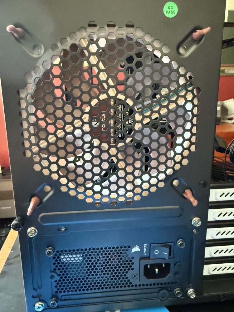

I ended up buying one to throw into a North XL as an exhaust, along with the two that came with a D15 G2 (which I didn't purchase myself). I don't have pictures because I sliced three fingers open on cardboard during the build and was too enraged to mess with my phone. But it's exactly what you would expect from Noctua: A really solid, ugly fan with an overwhelming amount of accessories, which is quieter than the stock fans at every RPM. I keep it in the 20-50% PWM range and it's completely silent. Running at full blast it has a not-offensive turbine whooosh sound signature, versus the Fractal Aspect 140mm fans which are more like a plastic bag filled with angry buzzy wasps once they pass 1000rpm.
