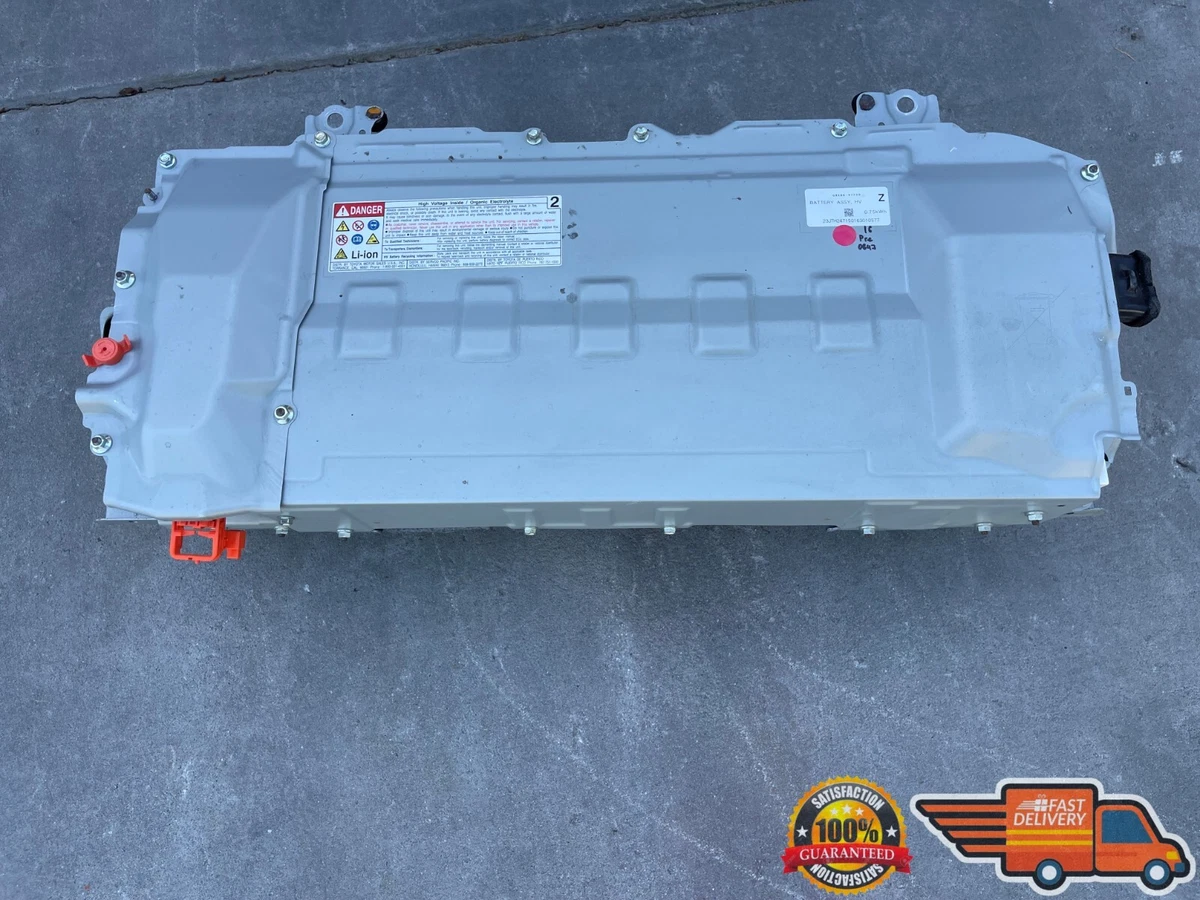

I mean this is a battery pack for a Toyota Mirai 2016-2020
This is a battery pack for a 2016-2021 Toyota Prius (it looks physically different in shape and dimensions and I don't think they are swappable)

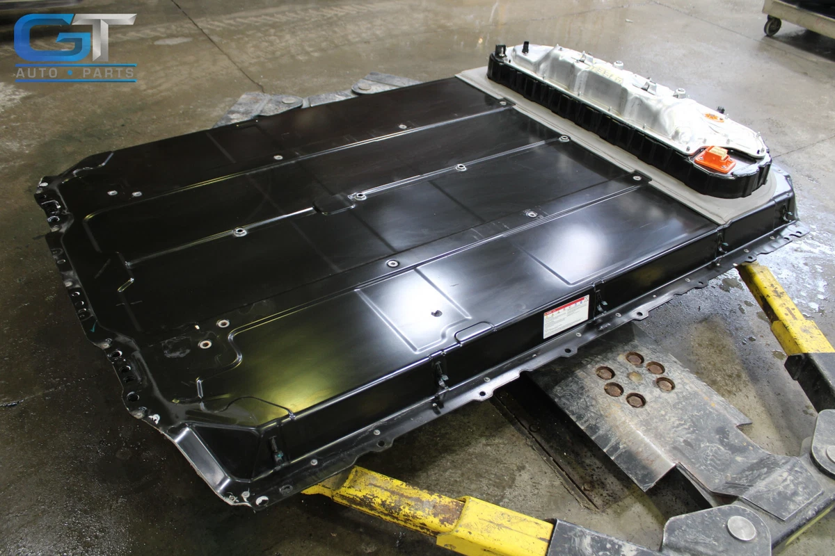

In contrast this is a 2021-2023 Model Y battery
This is a 2017 Model 3 battery
