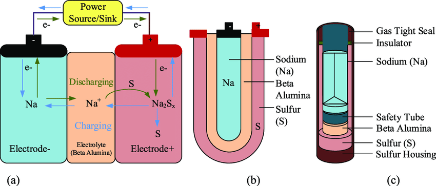

Interesting. Does the entire tank need to be at 300 °C or just the fluid at the anode, cathode, membrane junction?
I am not a chemist but I think it's the beta-alumina electrode you need to keep at 300 C to have enough ion conduction.
But I think you also need to keep the sodium and sulphur above their melting points (98 and 115 ºC) too.
In practice these high temperature sodium-sulphur batteries are built of cells like these (c) and the entire pack is kept at high temperature.
