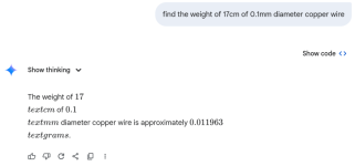

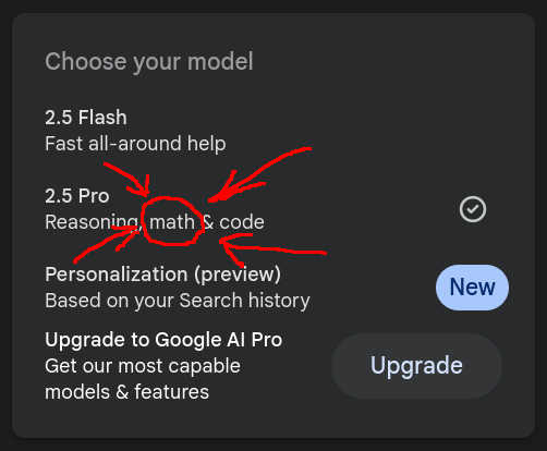

Despite the name "artificial intelligence", the currently hyped crop of large language models is not intelligent at all. Instead, it is a very large heap of statistical information about language, i.e. a set of numbers detailing correlations between words (or word-lets). The specific correlations have been "measured" by observing a huge body of existing text, and effectively counting occurrences.
I actually had been getting increasingly dubious that there's all that much learning of underlying patterns behind the text as opposed to learning instances of the text itself.
For example, there was the whole thing about (multiple different chatbots) miscalculating 9.11-9.9 . The excuse from AI enthusiasts was that 11 is encoded as its own token and blah blah blah rationalizations how that failure is not in any way indicative of anything whatsoever.
So lets think this through. I am supposed to simultaneously believe that this system has learned some essence of "how to code" from code, instead of just plagiarizing snippets with variables renamed.
But if I see a concrete real example of it failing, this is because with all the examples of arithmetic, it never learned that single-token 11 could be equivalent to 1 and 1. Or that 9 in this case could be equivalent to 90. All the gazillion examples of that happening in the training data, couldn't make it learn some simple equivalences.
Then there's people arguing that if they ask an LLM to implement a complicated algorithm it may be implementing it from a paper about it. That same thing couldn't apply children's books to subtraction.
edit: also sometimes AI boosters are their own worst enemy. I had a conversation with one, whereby to prove that Claude can reason they posted a transcript where it had done 4 arithmetic operations, of them 2 being "12042342 can be written as 120423 + 19, and 43542341 as 435423 + 18".
Prior to this I would have thought that an LLM would treat "X can be written as Y + Z" as equivalent to "X = Y + Z" . And I would have thought that it would have learned the pattern that [N digit number]+[M digit number] = [maybe 1][max(N,M) digit number] , and would have learned to re-create it, even if it uses multi digit tokens for some reason.
edit: Basically I would have expected it to have very low probability of emitting a space rather than a digit, until it gets to a plausible point for there to be a space. Because there's a very simple pattern to when instead of a digit there would be a space. And if it is encoding several digits into one token, then that token would bring ahead the appearance of the space, by appropriate amount.
Now I am thinking even though I was always very skeptical of claims about LLMs, I was not skeptical enough. I think LLMs usually fail to learn the sort of generalized patterns that we know small neural networks do learn (I myself did some neural network experiments a while back). Possibly it is an over-parametrization issue.

You're still using it wrong. What's the obsession with A x B? Just type it in a calculator.
Ever tested a product before releasing it?
The first step is that you take a look at what the claimed features are ("Reasoning, math & code"), and you check if they appear to work, starting simple.
A real use case may have some query where e.g. the tool looks up the density of mild steel and multiplies it with some other numbers to get a weight, saving user a lot of time comparing to googling up all the numbers and using a calculator.
Imagine TI releases an advanced scientific calculator, but if you try to multiply two numbers, the result is wrong.
Can you step back from "I think AI is great" part of the argument and recognize how pathological it is to, in response to such an issue, point out that you can use a regular dollar store calculator to compute the multiplication instead?
If you can train a model to use grep, rg, you can train it to recognize calculations and feed it to calc.exe. That Gemini failed to do so doesn't mean it is impossible, it's just not something they are focussing on right now. I wouldn't either, the use case is stupid, don't waste tokens on something this silly.
They did fix this in ~2 days, it must have been a relatively easy fix. For me at least right now it shows a fold out box for the code (previous didn't), and uses the calculator even if not asked to, even for 2 digit operations.
Anyhow the product description is "reasoning, math & code" not just "code". If you are doing "reasoning" a necessity may organically come up to use a calculator. With code the best practice is usually to just write out the expression straight in there, so there is a need to not perform approximate calculations.

It feels unfair to dunk on LLMs for being confident-sounding sycophants that are bad at math, but it's just an example that demonstrates they (1) are limited in unpredictable ways, and (2) give you no indication when you have exceeded those limits. Type an invalid program into Python, and it will complain about syntax errors. Type one into an LLM, and it will probably give you a made-up result to please you (unless it has been special-cased to shell out to Python). That's not something I want to build on top of.
A tiny little quantized model I have locally wrote me correct code for computing the Great Circle Distance (Haversine function) in a couple seconds, probably because it memorized it from Stack Overflow or Github. Sweet! That's faster than I could have done it. Then I asked it "what is 9.11 - 9.9?" and it gave me utterly confident but insane text salad:
To calculate 9.11 - 9.9, you subtract the two numbers directly. 9.11 -9.9 --------- 1.22 So, 9.11 - 9.9 equals 1.22.
I... don't even know how it ended up with that. So we have a fairly simple rule: whenever math is happening, call out to a real calculator. But what's the next place it will be confidently wrong? Are we sure we caught all the math? What if we said "optimize the following C function" and it did its own constant-folding or loop-unrolling?
I just worry that the "prompt guide" will be extensive, weird, and never quite enough to corral the stupidity.
Reactions: Dmytry
Dmytry
11,408
I agree its unfair to dunk on LLMs for being bad at math. I'm dunking on this product:
I can't even comprehend all that needs to go wrong at Google culturally, to take a tool like this from "experimental" to "stable". And not some minor thing, the better version of what they put as the leftmost tab in their search page.
edit: and to loop back to "coding with AI", Google is doing everything with AI and it does leave you wondering if there's some brain-rotting effect they got, company-wide, because leaving aside all the philosophical questions of machine sentience, ethical questions of plagiarism, and so on, this is objectively very pathological.
edit: also in between the release and the apparent fix, I had my own trick for it, "use an external calculator" worked and "use an actual calculator" did not. It takes a lot of time to test if something like this works, or if its just sampling error & placebo effect, though. Any trick like this would require dozens of prompts just to obtain a statistically significant result that it works.
Reasoning, math & code is rather broad though. But when I think of math, I don't think calc.exe replacement, but more like what I did last:

Honestly, I feel that Google describing a chatbot as "reasoning, math &" is sort of like "guy proposes to his chatbot" news. There is absolutely no way that their product can pass even the most cursory traditional QA, unless they just fire anyone for any kind of critique.

Dmytry
11,408
Manufacturers literally tell you how much 1000ft of #10 AWG wire weights. Here's my best attempt at recreating the question from a year ago, first attempt:
Show code does show a reasonably formatted answer, though, so I guess it's not entirely unusable, and it didn't just make up something. It just wrote some sort of a haiku.
I only started seeing "show code" 2 days after their "stable" release, possibly in response to people poking fun at its "math".
Anyhow, my point is that the most basic attempt at QA fails instantly. It is like clicking the first button in a dialog and it crashes. Yeah yeah yeah people who are dogfooding it may just never click on the first button in a dialog, that's why you QA stuff.
edit: in particular I've seen that phenomenon with extremely buggy apps before. Developers learn not to trigger bugs.
